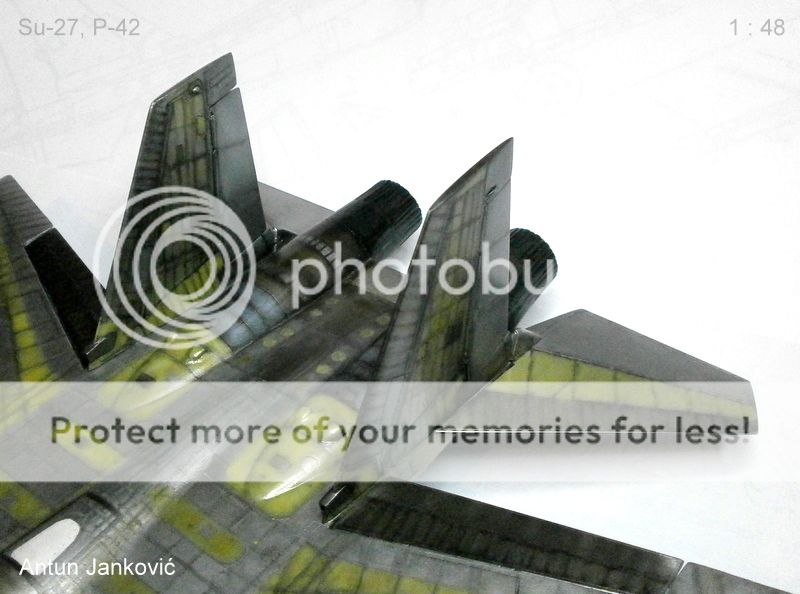

Prekrasan je slažem se ovako obojan, predobro bojanje i sve vezano uz to, ali Antune hmmmm ......Upozorba........ ne znam zbog čega pogreška koji nisi napravio na 1:72 mjerilu.....
Svi pomični elementi (predkrilca i flaperoni) na krilima ovog aviona su FIKSNI i u ravnom položaju fiksirani.
Tamna boja flaperona koja se na fotkama vidi nije sjena od spuštenog položaja nego su fiksirani u ravnom položaju i izrađeni od lakšeg materijala i skinutog mehanizma za pokretanje . Upravljao je u letu isključivo sa horizontalcima i kormilima na vertikalcima.
Pogledaj ovaj filmić :
http://www.youtube.com/watch?v=XwoqMwGtIjQ
A za sve koji ne vjeruju evo i citat teksta s ovog linka:
http://www.aviastar.org/russian-aircraft/flanker/flanker_2.html
"........The plane was stripped of the weapons control system and radar to make it fit the weight constraints. Besides, it had the central tail boom shortened, tail area reduced, drag chute and fences removed, wing high lift devices keyed, radar nosecone was replaced with a lighter metal one. ......."
I ovdje:
http://www.kamov.net/russian-aircraft/sukhoi-p-42/
"........To lower the aircraft’s weight the aircraft was modified:
the radar nose cone was replaced with a metal nose cone; the speed brake, its hinge fittings and its extension and retraction system were removed from the aircraft; the former speed brake installation area was structurally refined; the ventral fins were removed from the tail booms; the variable doors on the air intakes were locked in their optimum positions; wing panels with fixed leading edges were installed; the flaperons were removed and replaced with a fixed structure ;the missile launchers were removed from the wing tips; the tips were removed from the vertical stabilizers; the mud guard was removed from the nose landing gear; the aircraft was equipped only with the flight, navigation and communication aids required for safe flying; weapons hardpoints, the built-in cannon and the cartridge container were removed. ......"
Pratim i dalje sa guštom i čekam fotke donjeg dijela sa ugrađenim dijelom za kačenje sajle. Otpuhuje pjenu Dva prsta gore
su27rules: poruka promijenjena dana: Sub Lis 25, 2014 10:20 pm; prepravljeno ukupno 1 puta
I ovdje:
Vidiš, nisam to znao. Hvala na obavijesti. Popraviti ću.
A baš ti je bitna ta kuka ha? Confused Laughing Nisam još smislio kako ću, ali nešto ću već smisliti.... Cool

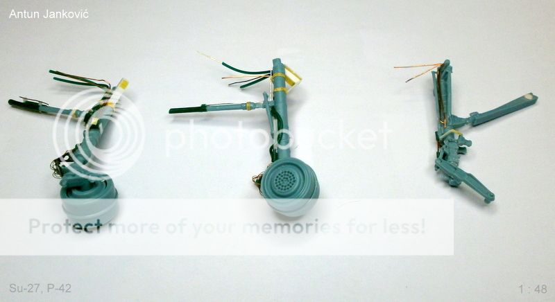

Evo konačno više-manje završio i stajni trap. Slijedi još bojanje....

Poruke: 3053
PorukaUpisano: Pon Velj 02, 2015 11:44 pm    Naslov poruke: Citiraj ovaj komentar
Bravo Antuneee!!!
Poruke: 4561
PorukaUpisano: Uto Velj 03, 2015 10:39 am    Naslov poruke: Citiraj ovaj komentar
Lipo,lipo!!

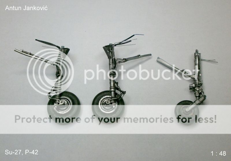

Točkovi gotovi:

Antone odličan rad na nogama, ma predobro!!
Ali meštre falio si boju nogu, aiko ovako obojane izgledaju baš dobro i meni osobno super. Ipak noge su standardno sive boje, nije goli metal:
Isto tako i unutrašnja strana felgi glavnih kotača ti triba biti standardno zelena, nisu na tim dijelovima skidali boju radi olakšanja težine.
su27rules: poruka promijenjena dana: Pet Velj 06, 2015 10:31 pm; prepravljeno ukupno 1 puta
Antun Janković
Član od: 04 Kol 2008
Poruke: 2299
PorukaUpisano: Pet Velj 06, 2015 10:24 pm    Naslov poruke: Citiraj ovaj komentar
Jesi li siguran da nije oksidirani aluminij? Navodno su s njega skinuli svu boju...
potpis
Poruke: 4561
PorukaUpisano: Pet Velj 06, 2015 10:34 pm    Naslov poruke: Citiraj ovaj komentar
Antun Janković Napisao/la:
Nije bez boje sigurno, zato sto i unutrasnja strana poklopaca kotaca ima standardnu sivu boju, ni tu nije skidana boja kao ni po unutrasnjosti tih prostora. Da idemo logikom da su bas svu boju skinuli onda ni kokpit ne bi imao boje Wink
Ali ako zelis slobodno napravi, odnosno ostavi ovako obojano, meni su ove noge koje si napravio odlične.
Unutrašnja strana felgi glavnih kotača ti triba biti standardno zelena, nisu na tim dijelovima skidali boju radi olakšanja težine.
I ovaj tip felgi koje si stavio za glavne kotače nije točan.
P-42 ima stari odnosno prvi tip felgi, sa samo jednim malim otvorom u sredini felge, stari tip felge, ne ovaj kojeg imas u kutiji Academy.
